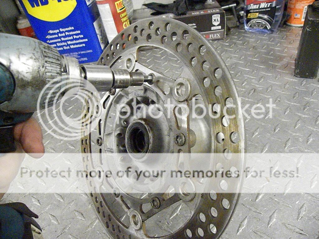

So, here is a picture showing you what most of these people have done:
DO NOT DO THIS!!!
The Allen head is too weak to overcome the extra resistance from the thread locker.
