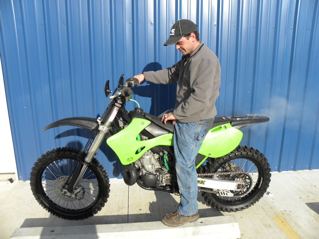

Here's a pic as we bought it:

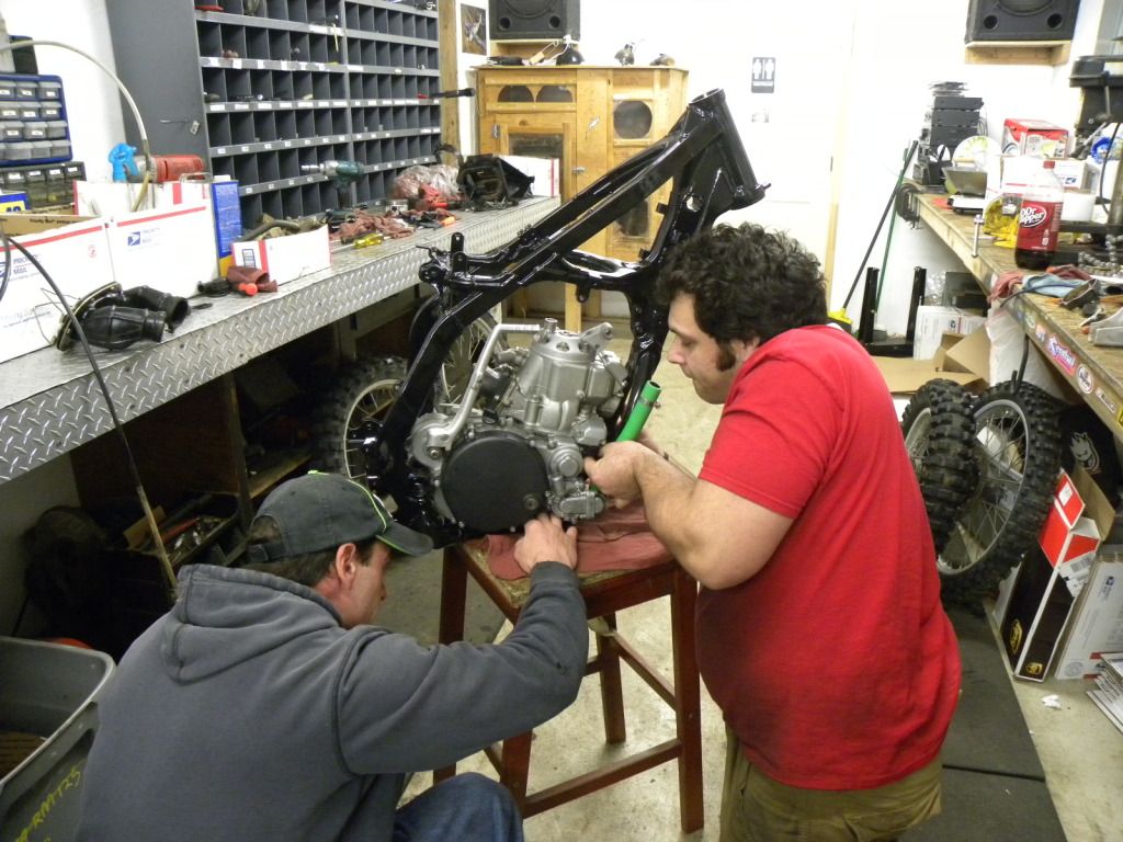

While we had it apart my employee wanted to do a little work to it which led to taking it all apart for painting ect.
The one on the right is who the bike is for, the one on the left is a guy I have known for years that loves to tinker

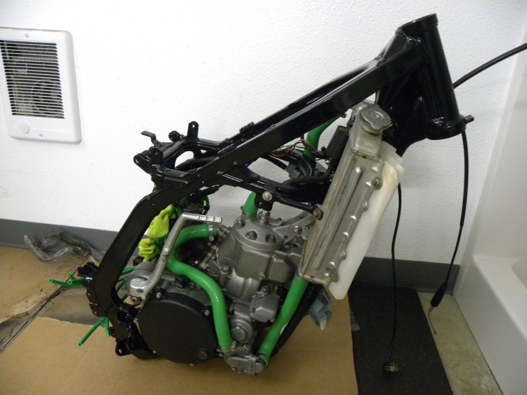

This is as far as they got last night 3-29-12

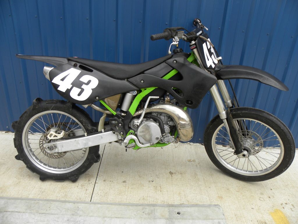

Re: 2000 KX250 KAWASAKI CHEAPIE REBUILD?
Just an update.
The bike has been out and rode a few times.
It runs great!
Excellent power, cooler temps, and has that freshly rebuilt 2T crack.
Couldn't be happier with the machine work and the end product.
