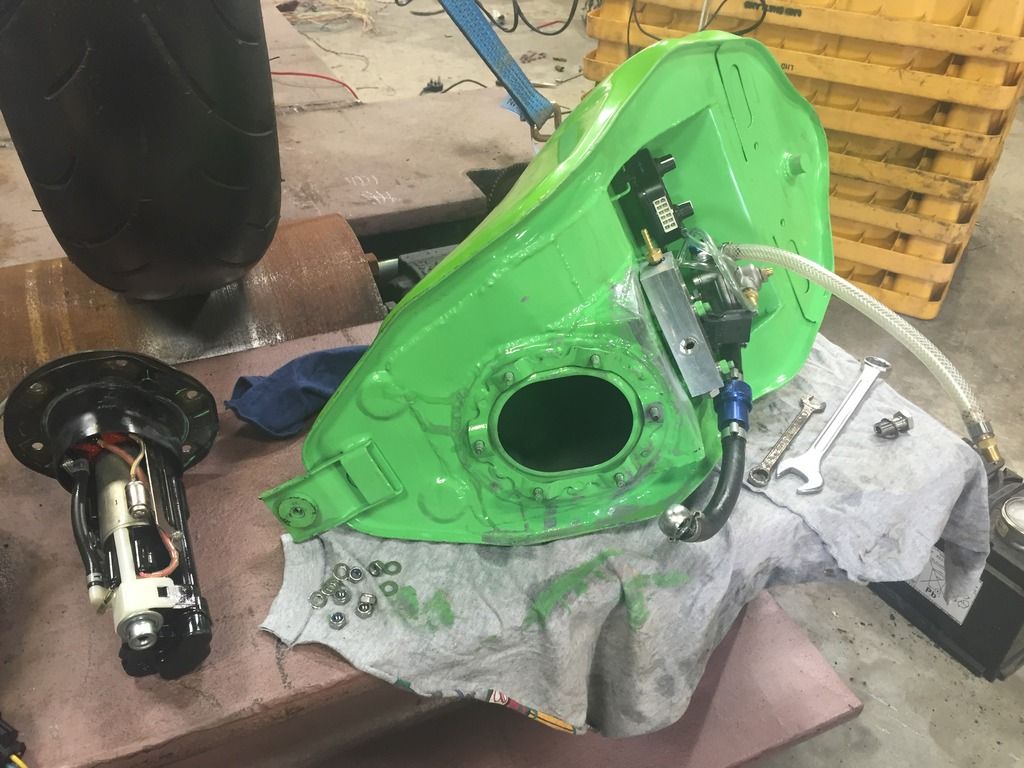

Fuel pissing out.
Around the pump gasket and at the pressure side of the FPR.

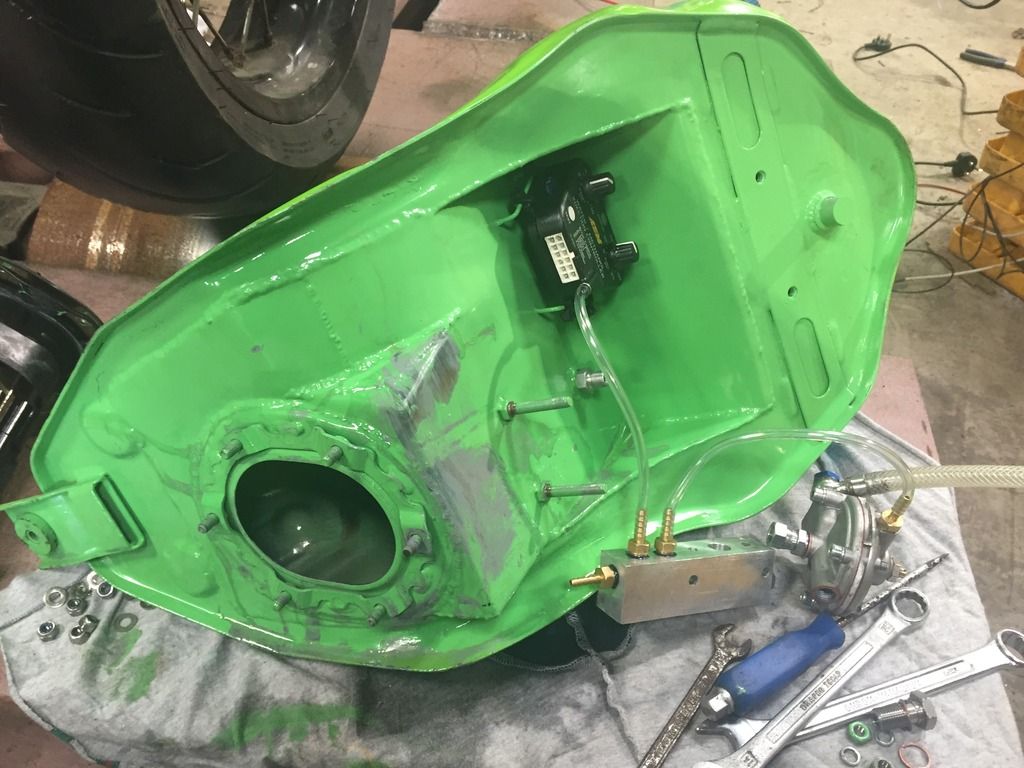

The paint melted too, just to put a cherry on top. So there was nothing to do but empty the tank. Look at it, what a mess. On the upside though I tested the FPR pressure as I was emptying the tank and it's good. 0-2.5psi by adjusting the screw under the nut on the top.
So good things and not so good things, hey, that's life baby!!!!

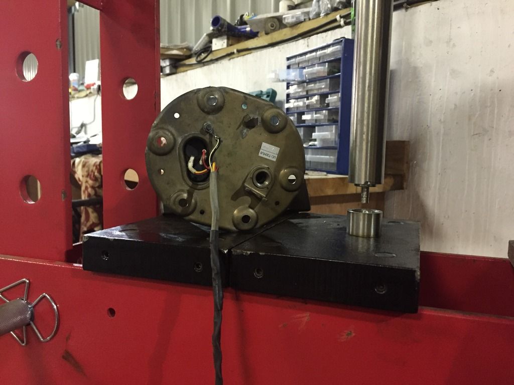

The pump was leaking because there was not enough crimp on the rubber seal. It was probably in the welding the section of the fireblade tank got depressed in the middle. So my solution was to make a press and die to lift the bottom of the pump so it allowed the pump to get pressed up more onto the rubber seal.

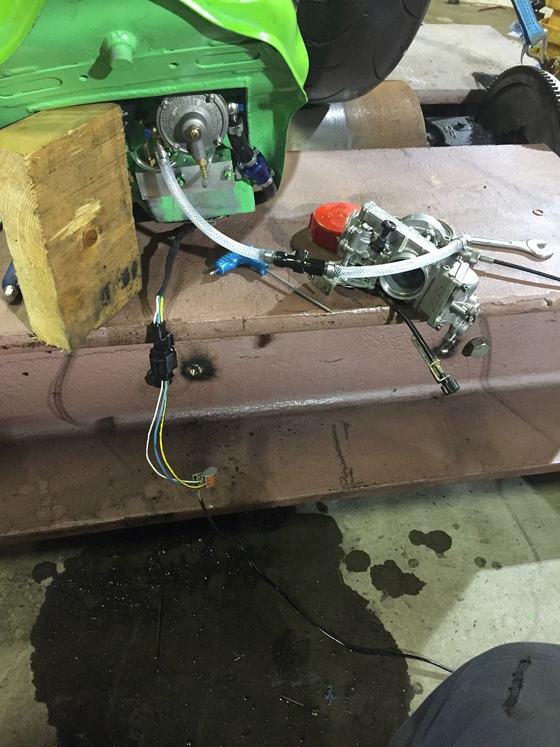

So, test 2, the seal on the pump is good now but still some leaks from the banjo bolts. Just a drip now and again. Ok so I'm thinking with some good sealant it will be good. So I hooked up the carb. More leaks. I had the pressure up around 4psi and the float valve leaked past but even more pissing off was the float bowl seal leaked too. Bugger. So I sripped it all down to put some sealant on it.
So, test 2, the seal on the pump is good now but still some leaks from the banjo bolts. Just a drip now and again. Ok so I'm thinking with some good sealant it will be good. So I hooked up the carb. More leaks. I had the pressure up around 4psi and the float valve leaked past but even more pissing off was the float bowl seal leaked too. Bugger. So I sripped it all down to put some sealant on it. Here is a video I made while the pump was running. Leaks might be sorted now. With a little less base pressure the needle valve might be ok.

Well I am a bit surprised how difficult it is to tighten the connections. I will have to get it sorted or it will be a fireball on the dyno when the boost ramps up the fuel pressure.
Yeh, few issues to sort, the leaks in today's test was where the pipes join the fittings. Gonna try different pipe and clips. The float valve is leaking by at 2psi so in conversation with a guy about a new one.

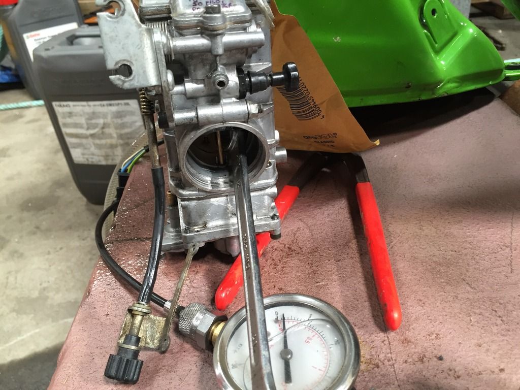

Had the float valve leaking at 0psi, the little spacer plate I made out of the FPR I ruined seems to be working good though, I can adjust the pressure from about 0psi (although I think it must be just the + side of that) to 2.5psi.
I ordered a new float valve and it arrived, I fitted it and I'm getting nearly to 2psi before leak past now.
In this picture the spanner is just there so I can see the top of the emulsion tube easier.
It is sitting around 1.5psi there with no leak.
