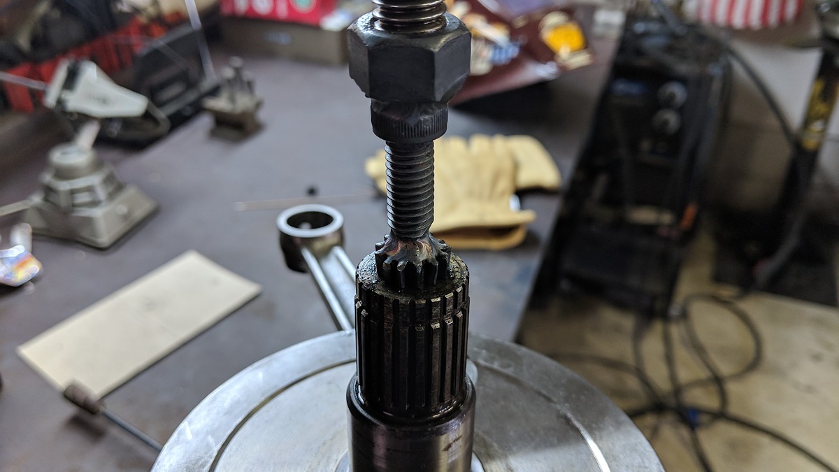

I'm going to weld a nut on, heat the crank a little and try to slide hammer it out.

That will work as well...
There are always lots of ways to repair :lol:

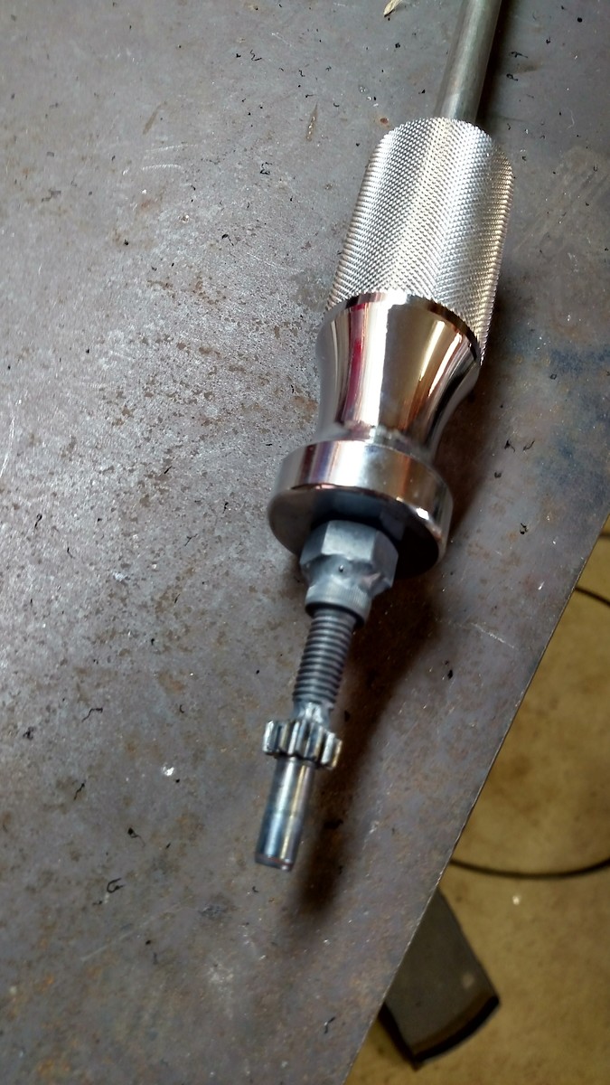

Post by Markee757 » Sun Dec 03, 2017 1:06 pm
Propane heat was not enough, had to fire up the oxy/acc torch.
Posts: 5682
Re: KX500 Crank Gear Spur for impeller/water pump. Question
Post by Sandblaster » Sun Dec 03, 2017 3:33 pm
Very nice.
You can certainly weld a lot better then me.
Most of the time guys break them off which is why they need to replace them :lol:
Great job!
