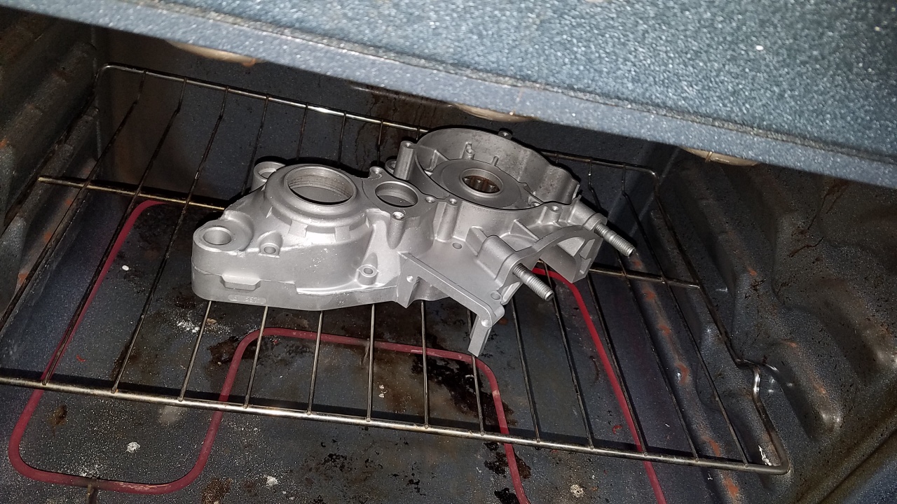

After spending some time on the porting table this case went through Vapor Blasting and is in the oven drying..

A little more progress..
One crankcase down and one to go.
